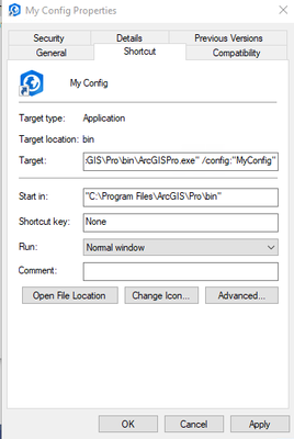

I tried 2.9.5 to see if there are any release related issues, but my test Configuration works fine on my test machine.   I assume that if you run the command line without the config parameter it works as expected and ArcGIS Pro starts up.   If i delete the Configuration from my folder:
C:\Users\<user>\AppData\Local\ESRI\ArcGISPro\AssemblyCache\{AddInInfo_Id_guid}
and then run ArcGIS Pro with my configuration (this is from a command line window):
"C:\Program Files\ArcGIS\Pro\bin\ArcGISPro.exe" /config:"MyConfig"
then ArcGIS Pro starts without the configuration.  This is expected.  For some reason in your case ArcGIS Pro doesn't start.  I suspect that your ArcGISPro.exe file location is not accessible.  My shortcut looks like this:
You notice that the shortcut icon is the ArcGIS Pro icon, in your screenshot there's an empty link, meaning the .exe or parts thereof are not accessible.  I would try this: under the logged in user (who has the problem), open a command line, copy the 'Target' field from your shortcut window into the command line window and run the command from there.  if that works make a new shortcut using the command line from the command line window.  If that doesn't work, check user permissions and the Pro installation location.

The shortcut icon was empty because it was looking for an icon on the network that wasn't there. Shouldn't cause any problem with just the .ico file missing. It is correct now. Please see attached image.
