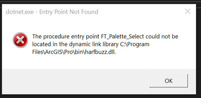

I did some further testing. I changed my Concurrent license to a Single Use license without any effect. After digging a bit deeper to find the cause. I get a weird error popup when initializing the 'ProApp' object, see image below:
Afer that I get various null pointer exceptions while instantiating the ProApp object at:
   at ArcGIS.Desktop.Internal.Core.SignOn.SetSignOnDlgCallback() in ArcGIS.Desktop.Internal.Core\SignOn.cs:line 77
   at ArcGIS.Desktop.Internal.Core.LicenseManager.InitProLicense() in ArcGIS.Desktop.Internal.Core\LicenseManager.cs:line 355
   at ArcGIS.Desktop.Internal.Core.LicenseManager.CreateLicenseManager(Progressor progressor) in ArcGIS.Desktop.Internal.Core\LicenseManager.cs:line 191
   at ArcGIS.Desktop.Internal.Core.LicenseManager.GetFulfillmentSource() in ArcGIS.Desktop.Internal.Core\LicenseManager.cs:line 547
And finally:
   at ArcGIS.Desktop.Core.Licensing.LicensedApplication.<CheckForLicenseAsync>d__12.MoveNext() in ArcGIS.Desktop.Core.Licensing\LicensedApplication.cs:line 67
The cause of all these null pointer seems to be the 'LicensingService' to be null after initializing the test mode. Unfortunately I am unable to debug this further and need some help here.
ArcGIS.Desktop.Internal.Core.LicenseManager.LicensingService
