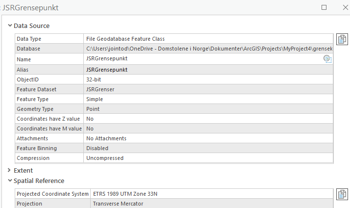

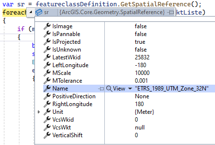

GetSpatialReference() returns the original spatial reference (32N) and not the current one (33N):
If I look at the same featureclass in ArcGIS Pro, I can see that the featureclass indeed is in 33N:
