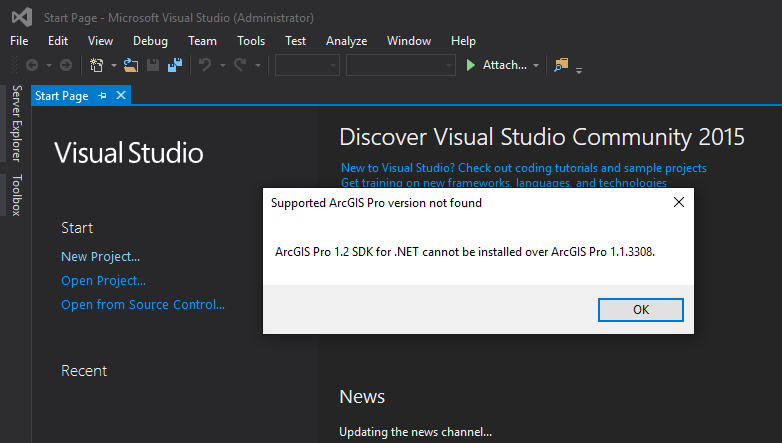

I am trying to start developing ArcGIS Pro add-ins but won't even get off the starting blocks. After proceeding as instructed in
ProGuide Installation and Upgrade · Esri/arcgis-pro-sdk Wiki · GitHub
and
ProGuide Build your first add in · Esri/arcgis-pro-sdk Wiki · GitHub
at the point where a new project is created based on ArcGIS Pro Module Add-in template, I get the following message from Visual Studio Community 2015:
I tried searching the web and the forums for this message but could not find anything. So, any ideas what could possibly cause this?
I am running Windows 10 Pro and have both Visual Studio Express for Desktop 2015 and Visual Studio Community 2015 installed.
Thanks,
Samuli N.
UmaHarano
Hi Samuli
Please download ArcGIS Pro 1.2 from https://my.esri.com/ and then you will be able to use the ArcGIS Pro 1.2 SDK.
This link will be useful to understand the requirements for ArcGIS Pro 1.2 SDK: https://github.com/esri/arcgis-pro-sdk/wiki#requirementshttps://github.com/esri/arcgis-pro-sdk/wiki#requirements
Thanks
Uma Harano
ArcGIS Pro SDK Team

SamuliNeuvonen1
Deactivated User
Thanks, this solved the problem! I had just a few days (weeks?) earlier installed ArcGIS Pro, so it didn't even occur to me that I could have an old version of the software...
Thanks to both,
Samuli
