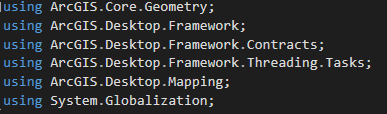

Hi Everybody, I inherits a visual studio ArcGIS project from an old collega. but when I open up the project in VS, it cant not find the ArcGIS namespaces.
It showing this:
And this:

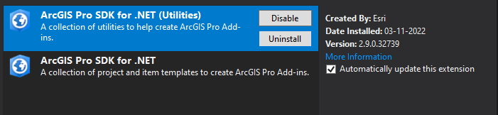

In my Extension manager I have install this:
I am using VS 2019 and the ArcGIS Project are used in AGP 2.9.

To support ArcGIS Pro 2.9 you need to install and use Visual Studio 2019.   Follow these steps to resolve the assembly path issue:
FAQ · Esri/arcgis-pro-sdk Wiki (github.com)
