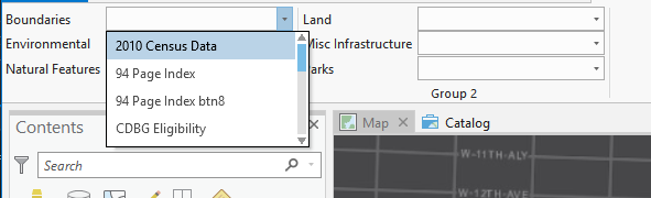

I am building an add-in to add/remove data from comboboxes and have encountered some issues.
Background: I have a repository of .lyr files that point to source data (in all formats: raster, vector) in various locations (file gdb, sde), so I built a combobox for each category to display a list of the layer name:
For the OnSelectionChange() I check if the layer selected exists by passing the selected "item.Text" as a key to a dictionary. If it does not exist, I return the path (its value) to a constructor so it is added to the active map and if it does exist, I want to remove the layer:
