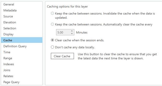

Additionally, I've noticed that SetDisplayCacheType(DisplayCacheType.None) does not seem to apply or update the layer's properties (checking via Layer->Properties->Cache).

When the cache type is set in code, is the Cache property tab supposed to update?  When I set cache type to None (or any other value), the UI has "Clear cache when the session ends" selected.  Also, ArcGIS Pro doesn't seem to use the value set via code, instead it's using the value seen in the UI.
ArcGIS Pro 2.7.3 is being used.
featureLayer.SetDisplayCacheType(ArcGIS.Core.CIM.DisplayCacheType.None);
