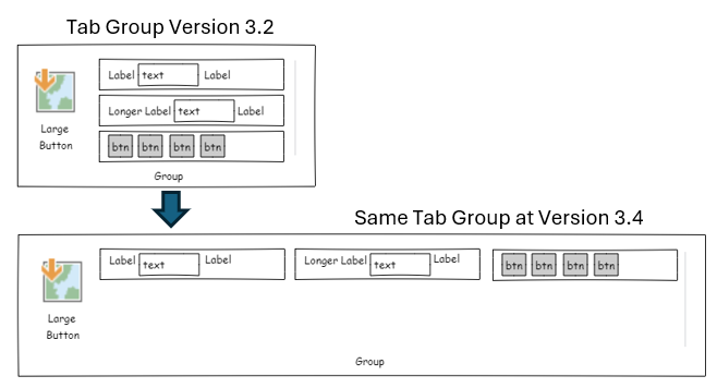

I recently upgraded from ArcGIS Pro 3.2 to ArcGIS Pro 3.4.  I had my add-in toolbar rearranged in a certain way where I was stacking items in a compact form (see picture below).  In my DAML, I have custom toolbar (module) where I have 3 groups of UI elements.  My first group, I have a large button followed by three toolbars.  Each toolbars had different UI elements such as labels, text boxes, and small buttons.  When I upgraded to 3.4, all my UI elements were spaced out like below:
What has changed in 3.4 that caused this?  How can I get it back to the way it was before?  There is also a lot more spacing between UI elements.

The toolbar behavior has indeed changed slightly with our new Ribbon control in version 3.4: toolbars can no longer be stacked with other controls, including other toolbars. This change was necessary for the new simplified mode. Could you modify your DAML to include just one toolbar with multiple groups, where each group will be placed on a new row?  Sorry the inconvenience. I'll help get Toolbars documented in the SDK.

JoeMadrigal
That worked!  Thanks for following up!
