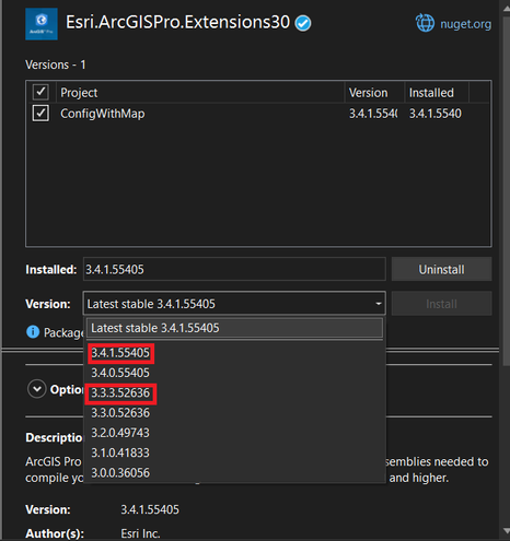

o Go to Tools > NuGet Package Manager > Manage NuGet Packages for Solution.
o Select the Installed tab and locate the Esri.ArcGISPro.Extensions30 packages.
4. Update the NuGet packages:
o If you have ArcGIS Pro 3.4 installed, update the Esri.ArcGISPro.Extensions30 package to 3.4.1.55405
o If you have ArcGIS Pro 3.3 installed, update the Esri.ArcGISPro.Extensions30 package to 3.3.3.52636
o Ensure all installed ArcGIS Pro SDK packages are updated.
