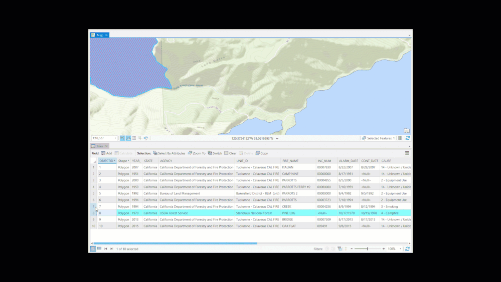

A new user of Pro complained that when he zooms to an object in ArcGIS Pro, all the flashing and color changing of the object takes too much time, which slows down his productivity.
I looked into the Pro options, but I could not find any settings for this. Am I missing something?
