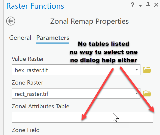

I'm trying to reclassify raster cell values based on where they intersect another raster. The primary raster classifies vegetation type, and I would like to overlay a second raster that classifies wildfire severity, then use the Zonal Remap function to change the vegetation type based on the wildfire severity (where areas of high fire severity exist, change vegetation cell values from "forest" to "grassland").
It seems like the Zonal Remap raster function would be the way to accomplish this, but I would love to hear if there is a more appropriate tool!
When setting up the Zonal Remap tool, I can't seem to enter a table into the field marked "Zonal Attributes Table" (see attached screenshot). There is no drop-down menu available to select a table, and I can't drag/drop a table from the Table of Contents or the Catalog pane into the field. Am I missing something? I'm using ArcGIS Pro 2.7.1

just tried it with two simple tif files.
Yup... no access
BUG-000101138: The browse button for the zonal attribute table is m.. (esri.com)
File a bug report, apparently you are the only person that has found this issue since Pro 1.4, alpha 4

@KoryKramer
you can't even select an existing table
There is no dialog help either
and from the function code
self.ztTable = None             # valid only if parameter 'ztable' is not a JSON string (but path or URL)
pasting in a path to a file????
and the data type is...  'dataType': 'string',
