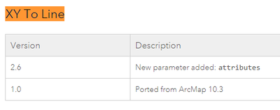

What version of ArcGIS Pro do you have installed?
At version 2.6 that new parameter was added.  See the toolbox history: Data Management toolbox history—ArcGIS Pro | Documentation
If you are following the 2.6 documentation, you'll see it described there.  But if you do not have 2.6 installed, that is likely the cause of the error.

Ah, thank you! That is the problem.  I am using version 2.5.
