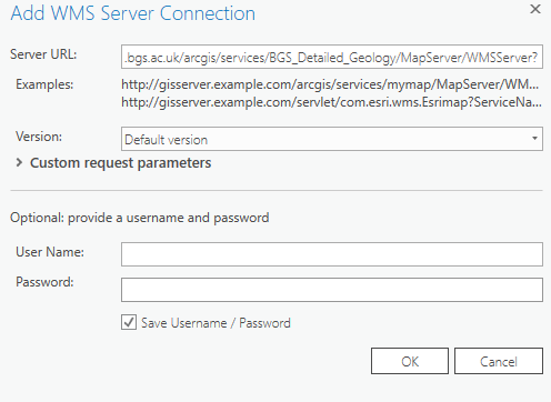

Insert>Connections>New WMS Server> paste the URL into the box and click ok

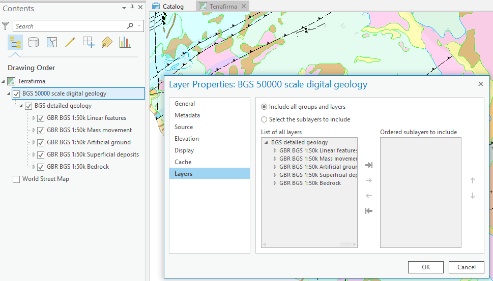

The WMS layer (and sublayers) display properly with the settings like this:

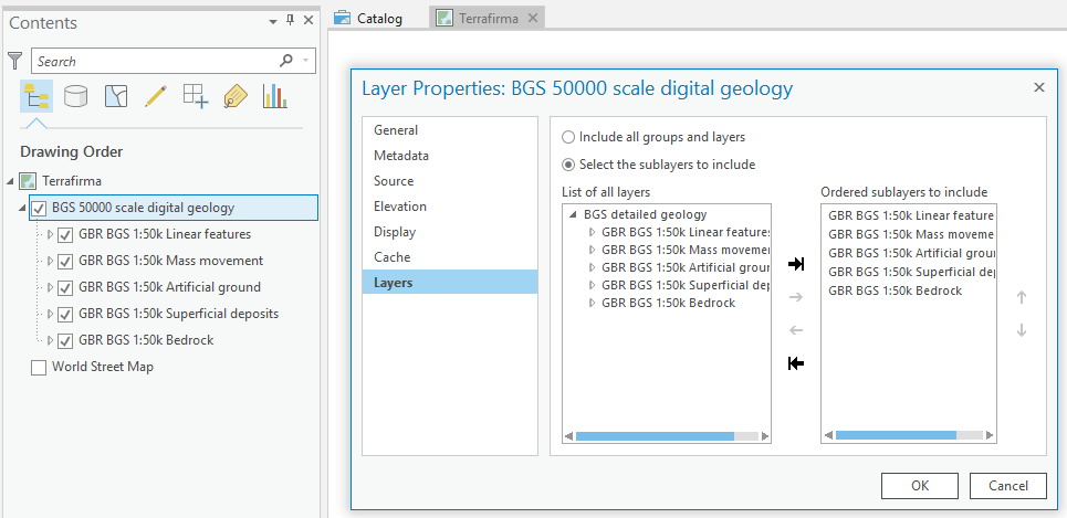

But if I change the option here to add the sublayers manually, the WMS layer doesn't display (see the white background):
If I then try to rectify this by reverting to 'include all groups and layers', it still doesn't display and I have to add the WMS layer to the map again.
There are no display scales on the layer and I haven't moved around in the map between changing the option.

I had something similar occur. I'm not sure what's going on. I tried one imagery service and it didn't work. This service had multiple layers. However, I added an imagery service using a layer file that only had one layer in it and that drew fine. One other difference was the format of the service. The one that worked used a REST endpoint. The one that didn't used some other kind of configuration.
This is the one that didn't work - http://geoint.lmic.state.mn.us/cgi-bin/wms?
SteveKloiber
I did find a work around. I loaded the WMS into ArcMap (which has always rendered this service just fine). I created a layer file for the service and then added the service using this layer file. The WMS worked fine this way. But if I tried to add it directly as a WMS service in ArcGIS Pro, it won't render at all.
Zander_Miao
New Contributor
Coincidentally, I had this problem today and I tried many things to no avail. Then I restarted ArcGIS Pro and it worked just fine, I don't know why. Of course, it's also important to make sure that the WMS version is the same.
JeffreyLambert
New Contributor
I was also able to solve this problem by restarting ArcGis Pro.
