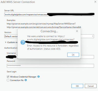

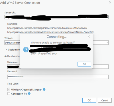

I'm getting an error trying to connect to a WMS service.  I'm using Pro 3.3.1.  I can successfully connect using my laptop but I get the error on my desktop.   Any suggestions to fix this?

Thanks for the suggestion.  I'm still getting the error.  The error regardless of how I try adding I get a 403 error.  This issue is a problem in one computer and not another.  In ArcMap, I was able to clear out some folders and it often fixed several issues.  Are there similar folders in the ArcGIS Pro world?
