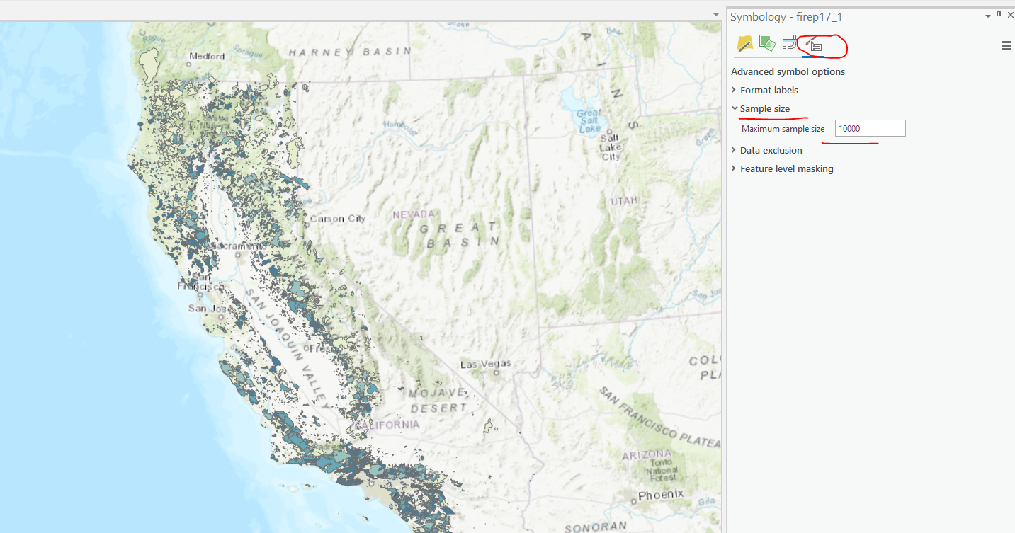

Have you tried upping the Maximum sample size?
KoryKramer
Esri Community Moderator
EricEagle
Hey Kory, that did the trick.  Because of the distribution I had to push it up to 163000 but it did work.  Thanks!
KoryKramer
Great.  You might want to go over here and vote up if you haven't: https://community.esri.com/ideas/14414-no-sample-sized-reached-error-in-arcgis-pro
