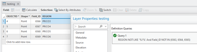

In this case, you'd want to use AND instead of OR. I think the confusing part for this query is that it uses NOT in conjunction with the OR. That will result in only filtering out the features that have "Canal" and are of ftype of 460 or 428. A feature of ftype 460 will be returned if it doesn't contain "Canal".
To illustrate that, I have a sample dataset where I'm filtering by Region and Field_ID. The original data looks like this
If I apply a query like you have to remove records that don't have 1 in the region name or are not 6563, 6564, or 6565, then the only record removed is the one with PRICO1 and 6564.
If I use AND in that query, then the three records are removed that meet either criteria
