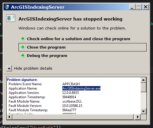

Several times per day I am receiving this error message, I'm not sure what's happening:
Here is the full text of the problem details:
Problem signature:
  Problem Event Name:    APPCRASH
  Application Name:    ArcGISIndexingServer.exe
  Application Version:    12.0.0.8933
  Application Timestamp:    59448914
  Fault Module Name:    ucrtbase.DLL
  Fault Module Version:    10.0.10586.15
  Fault Module Timestamp:    564ea777
  Exception Code:    40000015
  Exception Offset:    000000000006990f
  OS Version:    6.1.7601.2.1.0.256.4
  Locale ID:    1033
  Additional Information 1:    f1ed
  Additional Information 2:    f1ed9519d32e1ab1ad9c25d3f029ca3c
  Additional Information 3:    1606
  Additional Information 4:    1606ec217f97723d64bd81b579756a87
