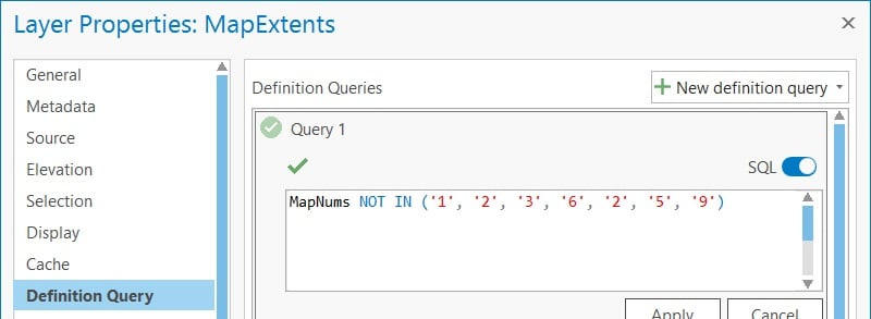

Hi all,

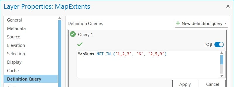

I have a field containing values that are comma separated lists [e.g. '1, 2, 3', '6', '2, 5, 9']. Note that this is three strings marked by single quotes.
I try to use values from this field in a definition query like so:
But, as soon as I close the dialog, the values get converted to a list of the individual values as strings - instead of three values, there are now 7 values ['1', '2', '3', etc.]:
ArcGIS Pro incorrectly converts the values
Only the value without a comma, '6',  is now correct.
I realize I can work around this by adding a field and converting the commas to some other character but I feel like this should not be necessary. Why is ArcGIS Pro altering the strings?

Hi MJ,
This appears to be related to the following logged defect.
BUG-000111347 : Layer definition query with “Add Clause” and “Include(s) the value(s)” on a text field with comma separated single values, is interpreted incorrectly and separates one value in the data into two separate values.
It is currently in the product plan to be fixed, unfortunately, I am unsure of the timeline.  If you create a case with Esri Technical Support, we can attach this bug to your account and you follow it's progress in My Esri.

You can also find the bug on support.esri.com https://support.esri.com/en/bugs/nimbus/QlVHLTAwMDExMTM0Nw== and click the Subscribe button!

BUG-000119957: In ArcGIS Pro, when using the 'Includes the value(s)..
This seems to be the Bug that you need to follow\subscribe to. The other one (BUG-000111347) has been marked as a Duplicate
