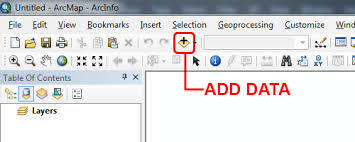

You can't just add a geodatabase to ArcMap. It is not a file (consider it as a folder, as mentioned by Xander). You can add the Feature Classes/ Feature Dataset (within Geodatabase) from ArcCatalog to ArcMap. Also you could add the features classes/Datasets using Add Data option.
Add_Data_Button
