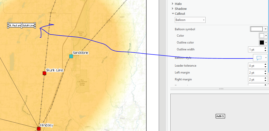

Why doesn't my leader line show?
8685
03-26-2020 06:52 AM
RandyMcGregor_Home
I have a text with a balloon callout set, but no leader line shows up. Leader tolerance is 0. I've tried different balloon styles and even simple line style. Is it necessary to set some other setting to get the leader line to pop out? I've moved the text all over. No leader exists. I've recreated the text from scratch several times.
Thank you,
Randy McGregor

Hi Randy,
Are you working with text on a layout  or with on map?
If you working with text on a layout right-click the text element and choose Add Leader.
For annotation on the map, of which I'm not an expert, there's these help topic - Add or remove a leader line—ArcGIS Pro | Documentation , Text symbols—ArcGIS Pro | Documentation and Set an anchor point position for callouts—ArcGIS Pro | Documentation .
Hope this helps,
Tom

RandyMcGregor_Home
It was in a layout, but I didn't know you had to select "add a leader line." Not necessary in ArcMap. Thank you very much. That was it.
KeithAddison1
For posterity: It works the same for graphic layers in the map with the right click add leader.
