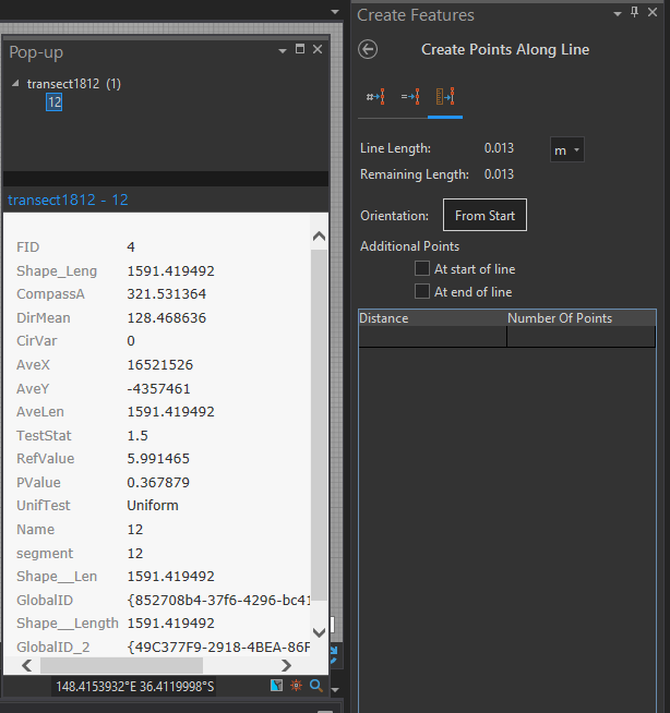

Why does the "Create Features, Create Points Along Line" feature edit function display an inconsistent line length.
2304
5
04-20-2020 08:45 PM
JozefMeyer
I have a line feature with an attribute length of 1591.419492, measuring the line gives the same value but in meters. When I use the "Create Points Along Line" function under editing it states the length of the line is 0.013m.
Any idea what I'm doing wrong?

Hi Jozef,
I'm not reproducing this:
What coordinate system is your line layer?
What coordinate system is the map?
Is this the only data you have that reproduces the issue?
Thanks,
Scott

JozefMeyer
Ah that's it! There was a sneaky transformation I didn't see when I checked the coordinate systems. Thanks for your help.

eotwmapping
Hello @JozefMeyer
Do you happen to know what you did to fix this issue?  I am currently running into the same issue and do not understand what I am doing wrong.
Thanks
ScottJones1
I think, I was bringing various features in different DATUMS, it took a minute but I was able to find the best DATUM for my area, then did a transformation to that DATUM... my biggest mistake is being self taught so I never truly learned the importance of PROJECTING data correctly
