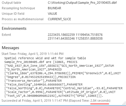

Rick - the Spatial Analyst team has been looking at this and in the daily builds of Pro 2.4 I'm running the tool on your data in less than 3 seconds.
So it looks like this will be working well with the release of 2.4.  To anticipate your next question (I don't have access to 2.4, what about now?) what you could do would be to run something like Raster to Point which will give you the elevation values for each cell, and then run Add Geometry Attributes on that to end up with x,y,z.  Hopefully that would keep you going until 2.4 hits the streets.
