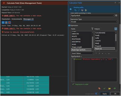

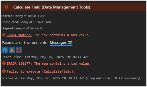

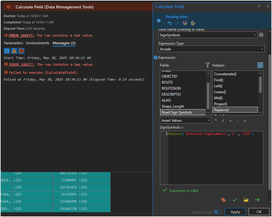

As I type the word Replace in the field using Calculate field to replace the I- to 255, however I get this error message. Has anyone went through this error and got it to fix ?
I looked at the Text Functions on ArcGIS Arcade in the ESRI Developer exactly but do not know why... Maybe some of you can help me out...
4 Replies
JoshuaBixby
MVP Esteemed Contributor
You have $feature.SignSymbols wrapped in quotes, which makes it a string and not a reference to the feature.
DEAF_PROBERT_68
Honored Contributor
So should I say or type it in as   Replace($feature.SignSymbols, "I-", "22")  ?
Joshua-Young
MVP Regular Contributor
Won't the Replace function create a new value of "225225"? Is the goal to remove the "I-" and just have a value of "225"? Could you just select all the features with a sign symbol of "I-225" and do a simple calculation of "225" as the new value?
