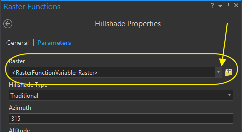

With just selecting the raster you should create the function as in ArcGIS pro 1.4. who can help me?

José__NorbertoMolina_Jiménez
select the raster (DEM)
I run a raster function
and the result is an error
You are supposed to execute it by just selecting and the same thing happens if you want to create a Create raster functions
in the pro version if it works well, must be a bug ...

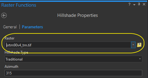

This caught me too some time back.
You need to actually use the drop-down menu on the right to select the raster you want the function to be applied to. Selecting it in the TOC is not enough.
In the below image the function is applied perfectly.
