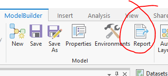

Because I can't export an image I explored the report button to see if this was a viable alternative.
Now I might be showing my ignorance towards other domains of specialism but I've got to ask who uses this reporting capability and under what scenario?
I've got a model with 54 steps and all this reporting tool does is list the inputs/outputs/tools. I can't think of any reason why I would need to view a model like that? The export button seems to churn out this information in XML format. Who and what would you use that for?
I personally see no value in this reporting tool, OK it gives a detailed description of the tools and their settings but if you don't know how they relate to each other what use is it? Am I missing something?
