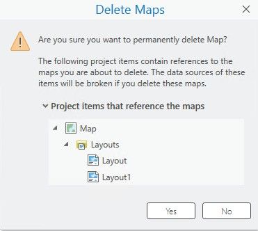

We have updated the message you get when deleting maps.
Unfortunately, this improved message is not available with 3.3.  It was introduced with version 3.6.  Until you are able to upgrade to 3.6 or newer you should be able to use the python script that @BarryNorthey linked to get the information you want. Thanks Barry!

Hi @DARRYLBEER
