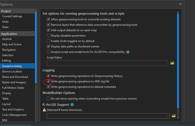

Thank you for posting, I was searching for equivalent of the Results window in Pro but have found thanks to your post it is not available.
One of our users is finding their tool (Solve, Network Analyst) is getting stuck at 50%. Would be really useful to have the Results style logging to track at what point the tool is getting stuck. It is nice to view this within Pro itself. I did find this, which seems to provide time stamps, file paths etc, but in a less user friendly way:
