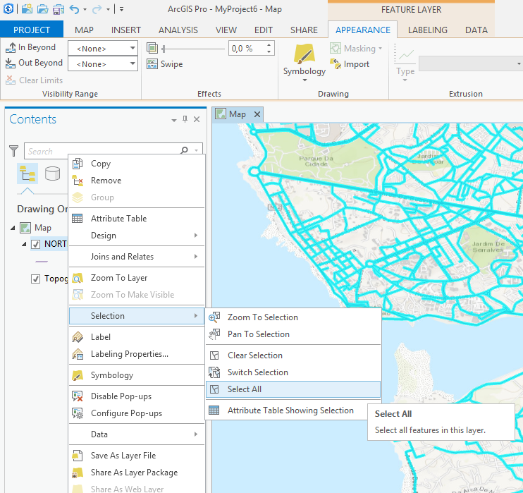

Hi, im using ArcGIS Pro and my impression are the vest. Unfortunetly dont find the option "Create layer from select features". Where can find it?
If the option doest existe , i hope that Esri Inc include this option in ArcGIN Pro because is a very important option!!!
Thanks,

Make Layer From Selected Features is included in the release of ArcGIS Pro 2.1.
Look for that release in January 2018.

An option is to consider is in the same Context Menu - select Data -> Export Features.  This starts the Copy Features GP tool.  Granted it creates a new feature class but would work.  Not sure if the ArcMap functionality is to be ported over in the future or not.

Just make your selection, then right click the layer in the table of contents. Instead of going to Selection, go to Data>Export Features. It automatically exports the selected features.
