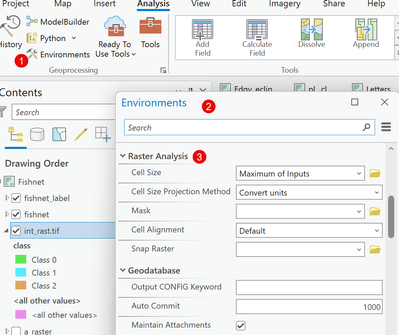

Did you try setting it in the Environments under Analysis?

select the raster whose cell size that you want from the cell size dropdown ....
you should really read up on the other parameters from the help topics.
Cell Size Projection Method (Environment setting)—ArcGIS Pro | Documentation
How the Cell Size Projection Method environment setting works—ArcGIS Pro | Documentation
Cell Alignment (Environment setting)—ArcGIS Pro | Documentation
Snap Raster (Environment setting)—ArcGIS Pro | Documentation
How the Snap Raster environment setting works—ArcGIS Pro | Documentation
They are extremely important to getting the results that you want and many of them have a large impact on the processing speed and processing outcomes.
