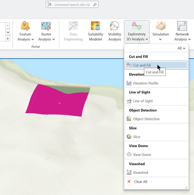

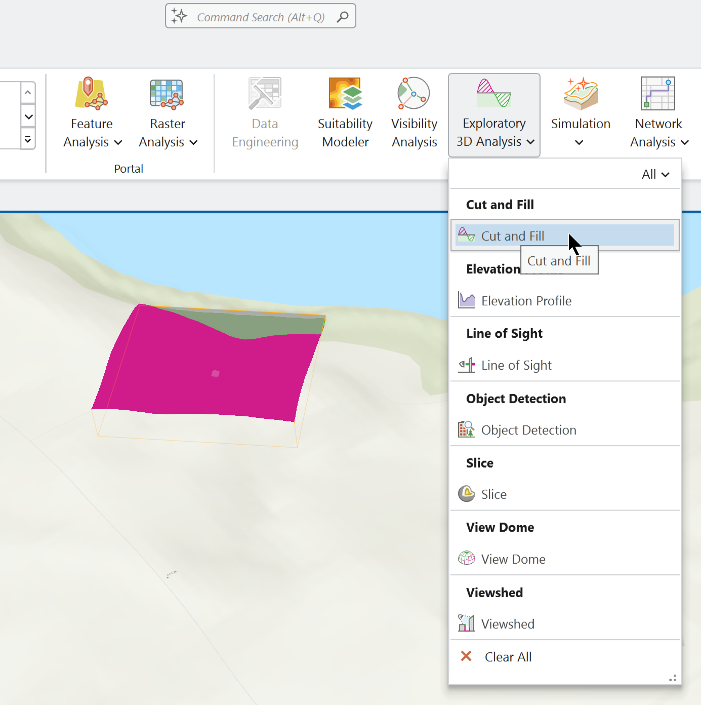

Exploratory 3D-Analysis Interactive Cut and Fill Tool does not calculate volume or area values if the Display adapter is set to DirectX 12 in ArcGIS Pro 3.4

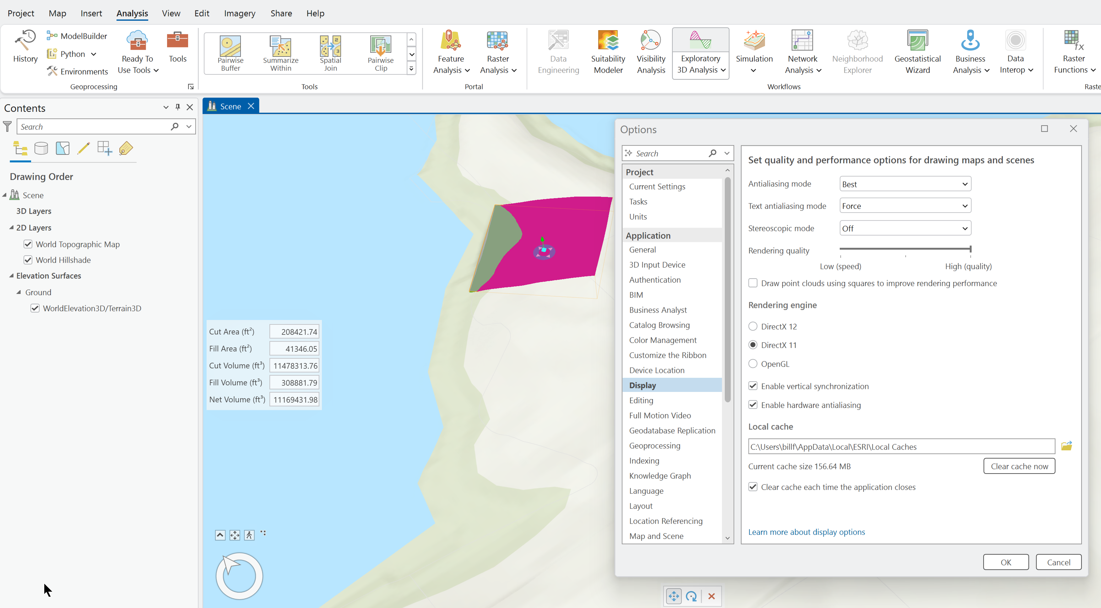

support's workaround is to change from DirectX 12 to DirectX 11

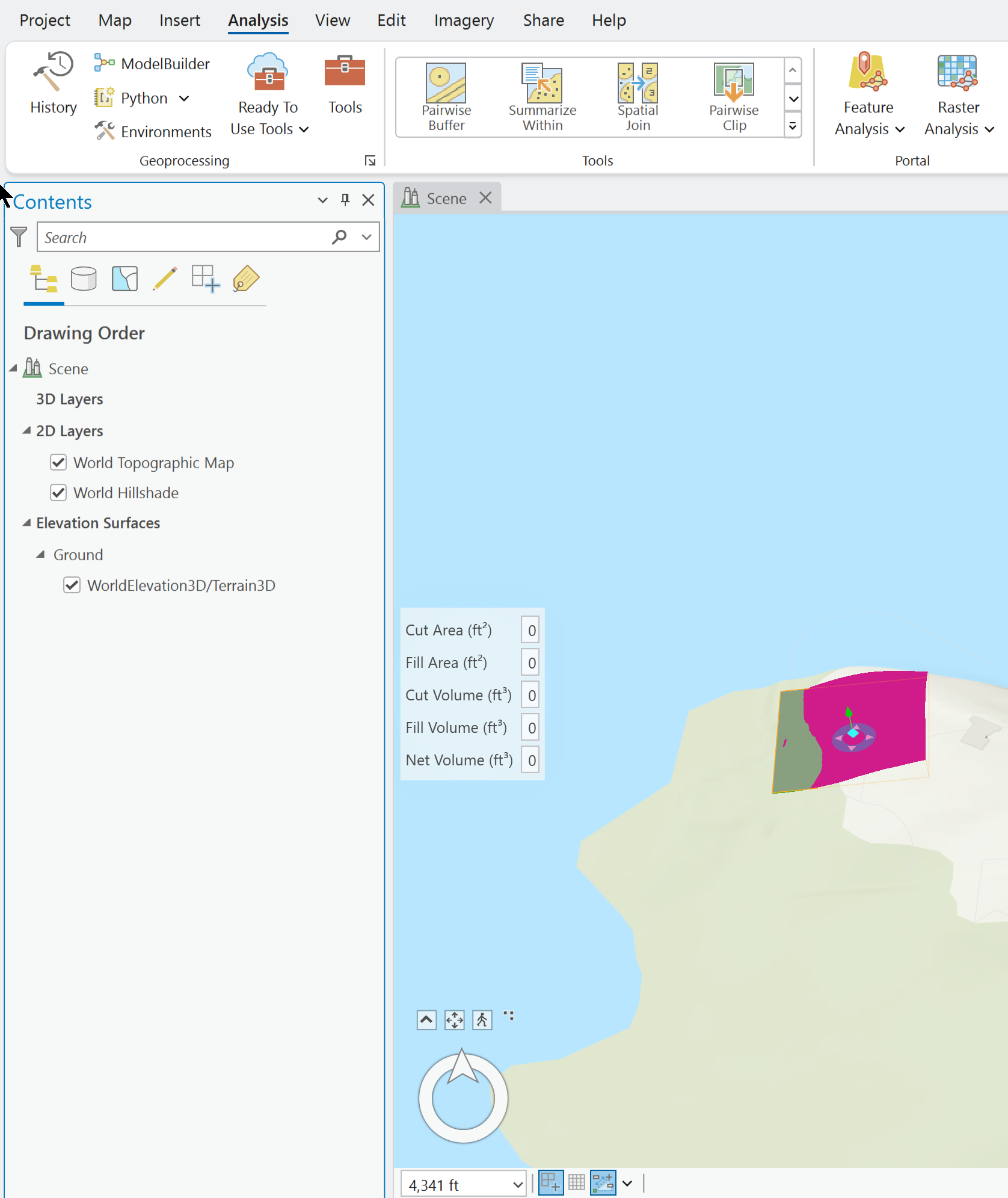

DirectX 12 shows all zeros in the analysis graphic

(DirectX 12) [all zeros]
DirectX 11 [working numbers]
