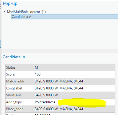

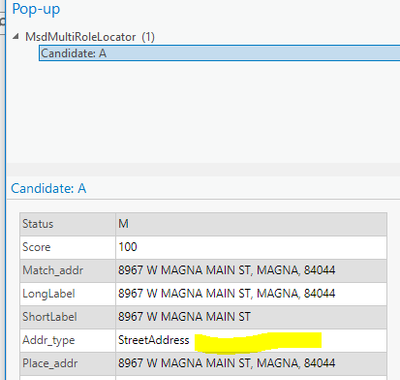

The new style locators are a complete paradigm shift so you'll need to sort of wrap your head around that.  In the graphic below I'm using a multi-role locator that has a point address role and a street address role in it with the locate tool. If I enter and address and it matches, I can then click details to see what role the entered address matched against.  In the first case the address entered matched against as a StreetAddress which equates to matching against my street centerlines data.
In the second case the entered address matched as a PointAddress which equates to matching against my site address point data.

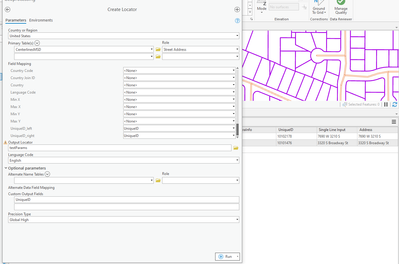

That's a really cool feature @ShanaBritt ; I've never known to do that but I can see how it can be very useful  In the test below, I use the UniqueID field which I have set up to populate from a database sequence when a new street is added:
