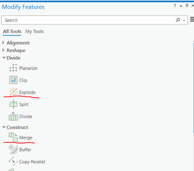

If you don't want to create a new feature (changes in input layer), then
1. Select All features
2. From Edit tools > Modify  Features, use Merge. Save edits
3. Use Explode from Edit Tools > Modify Features.
If you want the changes to be created as a new output,
1. Use Dissolve Geoprocessing Tool
2. To the output of the above tool, run Multipart to Singlepart
