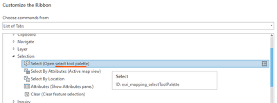

 As shown in the bottom screenshot, how could I set an accelerator to this tool? I have to say the some original setting is very boring

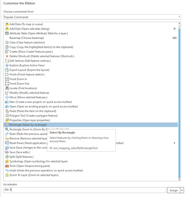

If you want to set an accelerator for something like the Rectangle (Select by rectangle) tool, you can find that under popular commands:

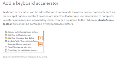

The select tool palette that you're showing in your screenshot cannot have an accelerator set because it requires user interaction to complete.
Here is the documentation https://pro.arcgis.com/en/pro-app/latest/get-started/customize-the-ribbon.htm#ESRI_SECTION1_0B9AD340...
