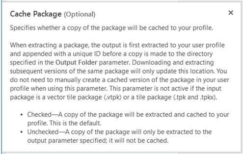

The advantage of this is you can specify where it goes. The “Cache Package” setting help is confusing, but I generally leave it unchecked to only go to the specified location. If you check it, it will also be copied to your Documents folder. I have no idea what the purpose of this is if you’re already telling it where to extract it.
