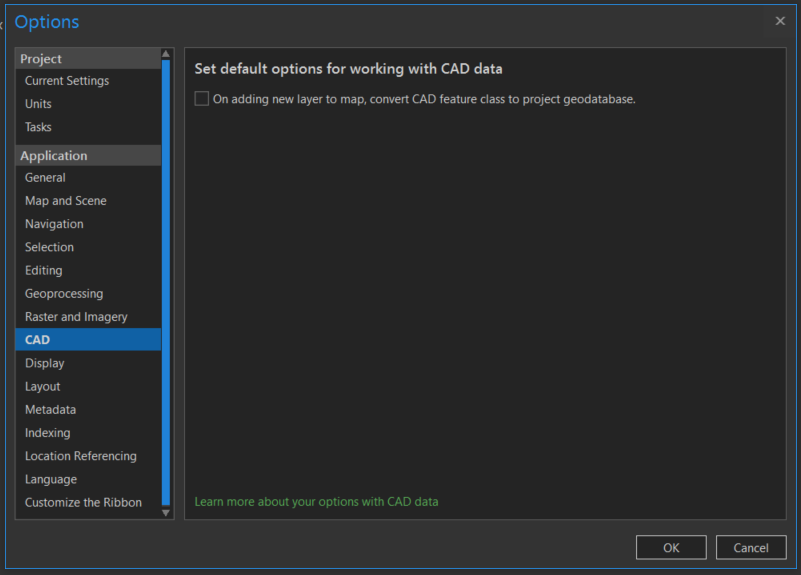

Yeah, true. I have seen that option to automatically add CAD files to gdb and have used it, but as most of us know, CAD comes with so much bloat that each file needs to be inspected/cleaned before blindly transferring it over:
When I load CAD into my map, I expect it to be somewhat temporary and I just want it organized a little stricter so that I can easily remove it instead of junking up my TOC.
I suppose it's just a preference thing.
