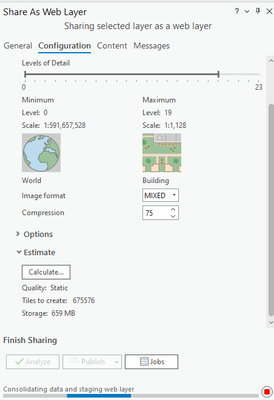

I'm trying to upload a mosaic to arc online from pro 3.2.2 and it's just gets stuck on "Consolidating data and staging web layer" for 8 hours and then stops.

Hi @ThomasGoodridge ,
Were you getting a particular error message when the job stooped? And where is your MD stored on your end? (Local file geodatabase or SDE) If you test publishing a smaller MD with less levels of detail, are you able to publish your MD to AGOL without any issue?

I was able to share them with less detail, but they're historical aerial photos and we need to be able to see changes to a property over time at a building level. The project is stored locally.

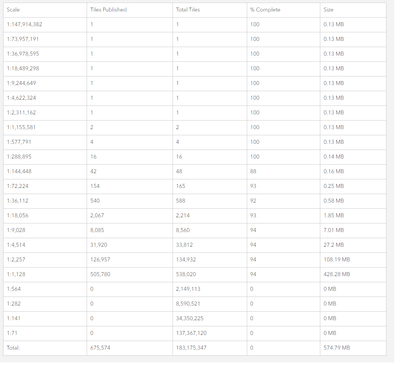

ThomasGoodridge
It's online now, thank you. But its not displaying anything and I don't have the option to build more tiles
