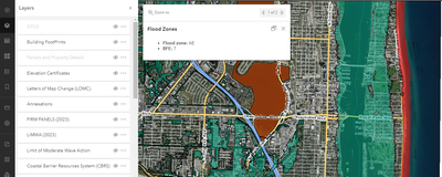

Do you actually need to be able to access the features (say for editing etc) on Enterprise?  Because if not you can publish it as a map image service and it will draw faster. You can still enable popups etc. I did this with our flood zone layer and some others that didn't need feature services.

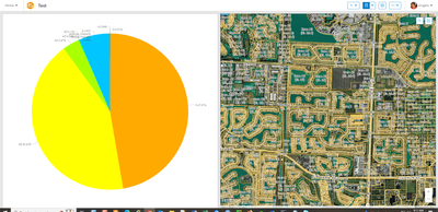

Can a map image service also be used in dashboard to connect with graphs and pie-charts etc?
AngelaSchirck
I just did a quick test.  I was able to add a pie chart to a dashboard for my flood zone layer (which is a map image).

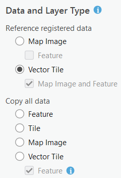

DavidSolari
MVP Regular Contributor
If you have access to these Vector Tile options, give them a try. You'll get a reasonably performant Vector Tile layer along with a service that supports popups.
