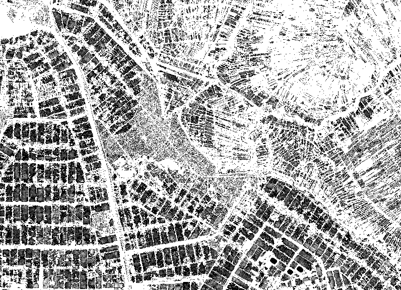

Can I calculate flooding in arcgis based on a geotiff with water elevation?
I have a geotiff file containing water elevations from 0 to 5 meters. In addition, I have a shapefile containing the perimeter of a number of properties. Now I would like to know what the water height in a building is based on the geotiff. However, I have no idea how this should be done, does anyone have an idea?
Thanks in advance!
The geotiff:
JohannesBierer
Don't know if I understand you right, but there's a tool "add surface information" in Spatial Analyst? Maybe you can use it to add the information of the geotiff to your feature class of buildings?
https://pro.arcgis.com/de/pro-app/latest/tool-reference/spatial-analyst/add-surface-information.htm
KimberlyGarbade
A few links that might help. Not sure the first one does what you want since it just shows the "volume" below a predefined elevation.
https://pro.arcgis.com/en/pro-app/2.8/tool-reference/3d-analyst/surface-volume.htm
If you actually want to.predict flooding then that is much more complex. You can use Spatial Analyst extension tools.
https://learn.arcgis.com/en/projects/predict-floods-with-unit-hydrographs/
