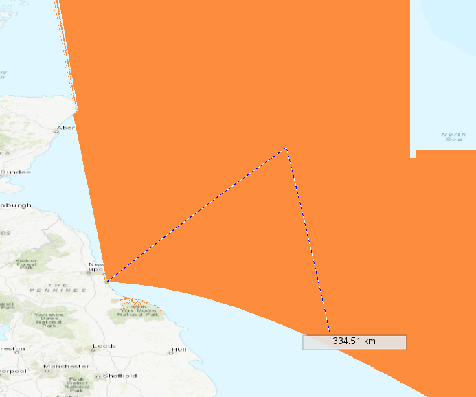

Visibility analysis:
- I am getting the following output for visibility analysis
- The procedure doesn't take into account the fact that it is unlikely that a viewer can see more than 20km (depending on elevation of observation point), is there a way of incorporating this into the output?

Did you try changing the default curvature from flat earth ?
https://pro.arcgis.com/en/pro-app/tool-reference/3d-analyst/visibility.htm
curvature_correction
(Optional)
Allows correction for the earth's curvature.
  • FLAT_EARTHNo curvature correction will be applied. This is the default.
  • CURVED_EARTHCurvature correction will be applied.
DavidRalston
Hi Dan,
Couldn't see this option in Pro. Just looked in arcmap and it's greyed out, any reason for this?
