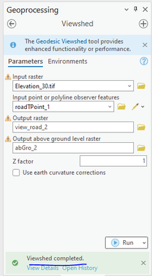

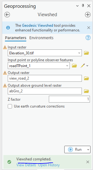

I performed a viewshed analysis to create a layer showing the visibility from roads.
Here is my input and output: I convert roads from lines to points as observation points.
It completed.
But the the map view displayed nothing. I zoomed in, also nothing showed.
Any suggestions how to solve this?
Thanks in advance.

The viewshed I performed complete, but the output file only two. No raster.

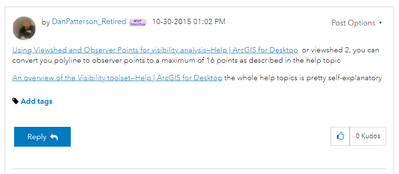

It might due to something wrong with the input point or polyline observer features for the viewshed tool. Now I am trying to use Feature Vertices To Points to convert the vertices in polyline road.shp to points as the observation points.  https://community.esri.com/t5/geoprocessing-questions/visibility-analysis-using-a-polyline/m-p/57677...
https://pro.arcgis.com/en/pro-app/latest/tool-reference/data-management/feature-vertices-to-points.h...
but I am stuck with how to limit the maximum number of points converted from vertices.

You haven't defined the raster type. Put .tif on the end of your output raster.
(Only leave the file extension out if your output is going into a gdb. If you've got an xml going into a folder somewhere, then you've not written to gdb here)
