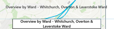

I'm trying to setup a map series and some of the longer map titles require two lines of space instead of one, this leaves titles that require only one line to appear too high instead of centered in the box (see image attached).
This would be fixed if I could change the vertical alignment but this is greyed out for me.

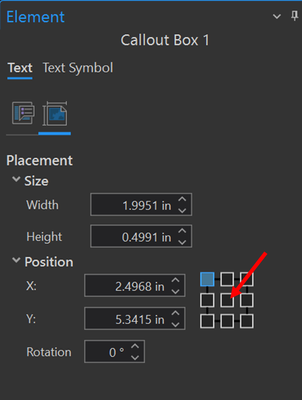

From the "Element" tab, try adjusting the position for the text from its current position to the middle position. Just an idea.
GISAdministrator8
Thankyou for the suggestion but this has no effect on the text box:

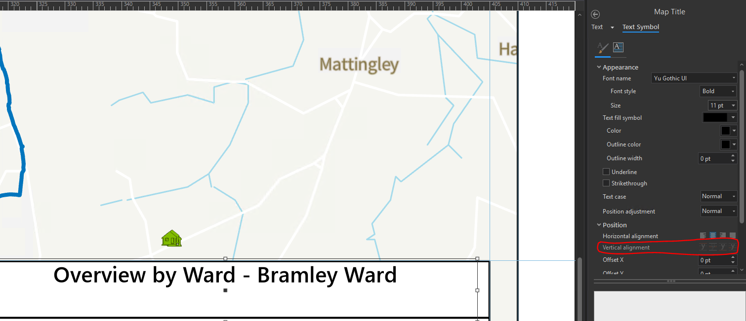

I've tried a few things and vertical alignment is available on Straight Text but not on Rectangle Text.
The problem with straight text is that it is in only one line where the font size scales depending on the line length, i also cannot contain it within the designated are/box for the title:
Rectangle text works fine for 2 lines of text as above but when changing to a shorter tile (changing map series) that only requires 1 line the text is stuck to the ceiling:
