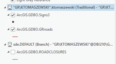

I am accessing a versioned database. All of my versions should be branch, but most of my layers are traditionally versioned and I don't know how to change it.
I don't have admin access & my admin is also struggling to solve this.
I'm not able to change via version manager or Project > Options > Versioning
Our Org runs a script to post all users versions at EOD. Mine that are marked as traditional aren't posting and I think this is the source of the issue.

There is not a tool to convert it directly, that I am aware of.
You would have to unversion the traditional data and reversion as branched.
Not sure how to keep the edits.
Are you connecting to the services that were published as branch versioned?
