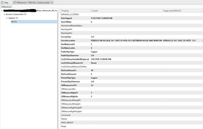

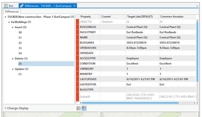

Since upgrading to ArcGIS Pro 3.2.0 the Version Changes / differences view is no longer showing data changes in the "Show conflicts" view.  From the documentation here, this is what I should see:
However this is what I see:
If I switch to the Show All view I can see where new information has been added to the attribute table, but cannot identify attribute values that have changed.

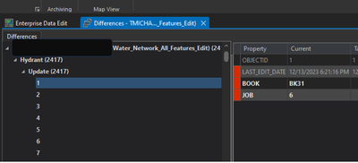

@Robert_LeClairThank you for the suggestion, I appreciate it.  I renamed the folders as you suggested and the behavior was the same.  I also tried creating a new ArcGIS Pro project and signing out / back in to ArcGIS Enterprise and those didn't make a difference either.

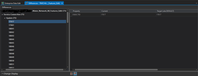

Show Conflicts view:

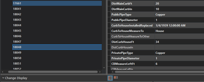

Show All view (updated attribute values visible):

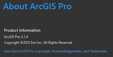

  • Uninstalled ArcGIS Pro 3.2 and installed ArcGIS Pro 3.1 and Patch 4 - and in this version the versioning changes window is working correctly again:
