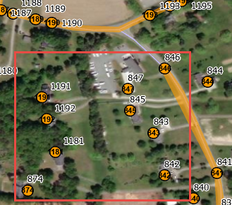

I have just created my first route in ArcGIS Pro using Vehicle Routing Problem tool within the Network extension. The route will be used by meter readers and contains roughly 2500 'stops' (they will not be actually stopping but driving by).
Upon examination of the routes and sequence of the stops I noticed that some locations out in the county that have long driveways are out of sequence.  The tool appears to want to place them in sequence order with stops on the roads behind them as opposed to the road that has access to the location's driveways. In the screen shot below I have shown an example of locations that should be sequentially numbered but are not.
I am trying to determine the best way to change these location's sequence numbers so that they make more sense. I realize I could simply change their sequence number to be in the correct order but unless I changed every sequence number for each stop after those I changed, I would end up with duplicate numbers. I'm guessing having duplicate sequence numbers would mess with the routing...?
Short of creating my own dataset and adding the long driveways to the route, what would be the quickest and easiest way to fix these records?

The best way to do 839-840 is to change the Curb Approach to Right Side of Vehicle.
Then change the Network Location (Source OID and PosAlong) of 1191 and 1192 to be the same as 845, then change 1181 and 874 to match 840.  When the Network Analyst is Run, the sequence should go up the right side of the street and then back down the right side of the street.  This is the safest method since the vehicle may have to turn up the long driveways by making multiple Right turns instead of Left.
Since the original solution goes up and down the street anyway, Right turns are also quicker since the driver does not have to deal with cross traffic.
