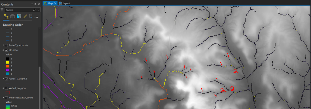

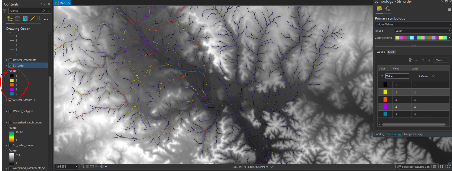

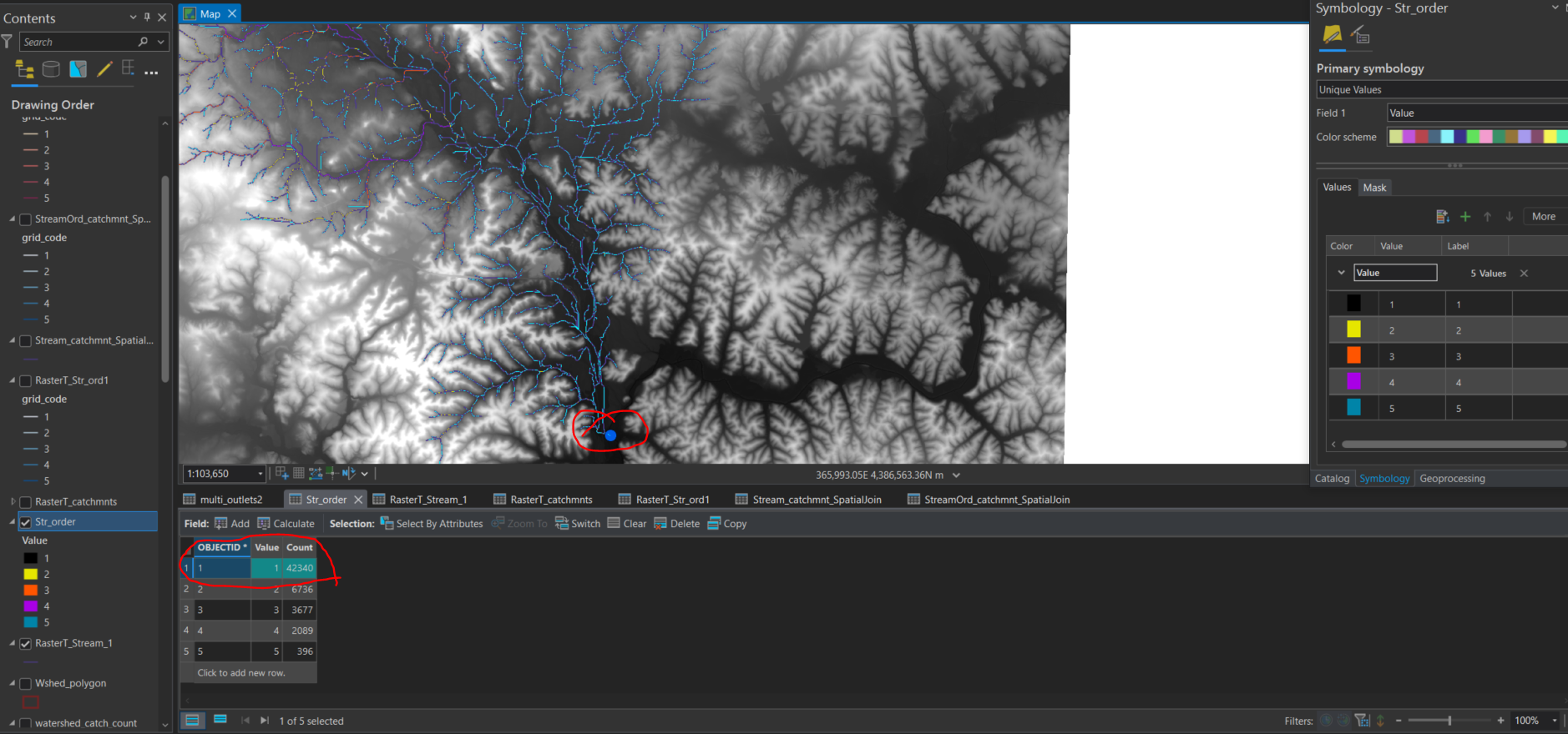

I am delineating a watershed and have produced a stream order raster. I used the Stream Order tool with a stream link raster as the input stream raster and the flow direction raster as the input flow direction raster. As you can see in the screenshots. The second screen shot is to show the outlet point and the selection of all the #1's. Why has it grouped so many streams that seem to be of a different order into #1?

What you are showing is the raster attribute table of your stream order raster, you get that with integer rasters. Its simply the count of the number of pixels for the pixel value in the entire raster. So in your example you have 42340 pixels with a value of 1 and in that dataset 1 means a headwater stream. You don't have 42340 headwater streams you need to be counting the segment number to determine that.

The reason I highlighted the #1 feature was to show those streams highlighted in the map to make it clear that they are all 1's. The part of the map where the different orders are shown is correct. The 1's are correctly black, the 2's are correctly yellow,... But to the east of those, 1's, 2's, 3's and 4's are black. I would like to know why that part of the map shows incorrect stream orders. I used the Strahler method. Please see below and thank you: stream order prob3.png

OK now I see the problem you are asking about.  My experience when such tools fail to generate expected answers, in your case two first order streams must increment to a 2nd order when they come together, is that the under lying DEM was not corrected for hydrological analysis. Typically a  first step is to pass the DEM through the fill sinks tool before computing flow direction and or flow accumulation rasters.  My guess is that section of the DEM has not passed through the fill sinks tool?  I would run the DEM through that to see if it corrects it.
