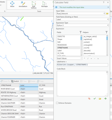

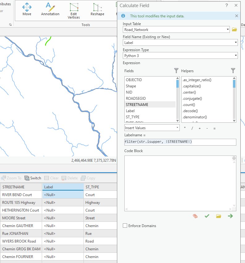

I have a dataset with a "Streetname" field that I would like to label with the name portion (shown as uppercase) but not the designation portion (lowercase). I'm sure that this can be accomplished with a label expression however I opted to create an addition "Label" field with the intention of populating it with a filtered version of the "Streetname" field. I thought I had a handle on how to accomplish this but obviously I am missing something important. Can anyone shed some light on this for me please? ArcGIS Pro 2.8.3

Try
''.join(filter(str.isupper, !STREETNAME!))
