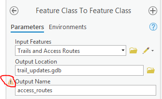

While this works as I want, I have not been able to get any error or warning messages to work in this code, I am not sure what I am doing wrong, there are a few 'setErrorMessage' lines (88, 100) in the code that do not appear to do anything when they should be firing. Because of this, to debug I used a rather brute method of changing the parameter value so it would appear in the GP window (commented out). I am trying to trigger this (picture below) sort of warning in my code, but it's not working. You can see in line 100, I'm trying to get it to trigger the warning no matter what and it still does not appear. Surely I am missing something stupid. We're on ArcPro 2.9
