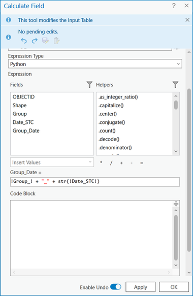

@GeeteshSingh07 @MichaelVolz As I try to join my dissolved table to the original table, I have no common field between them. I want to create a new field in each table that is a combination of the group ID (text and numbers) with the date field. How would I use the Calculate field tool to combine these two? Or, is there an easier way that I'm overlooking?
Jill_Clogston
Ah, I think I've got it. This seemed to do the trick!:
