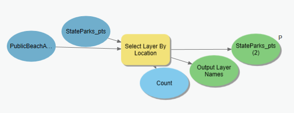

Thank you for the suggestion. The model is built from preexisting geoprocessing tools. I'll include an image of the simplest geoprocessing tool I'm trying to share, which does nothing more than select by location.
I've run the tool, and there are no errors in it. The output was added to the map document. Yet, the share as web tool option is still greyed out in the ribbon as well as not showing up as an option when right clicking the server that was added to the project.

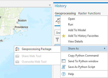

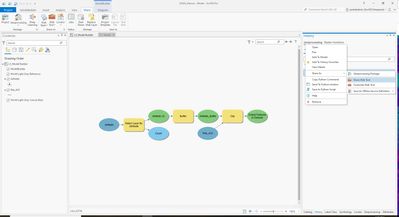

So the key is to run your model in the GP pane vs in ModelBuilder.  This way it creates a GP History of the model.  To open GP history, go to the Analysis Tab -> History (far left).  Right click the Model in the History Pane and click Share->Share as Web Tool.  You have to be connected the server URL in the Share as Web Tool GP pane in ArcGIS Pro and I believe be an admin (could be wrong here though)  See graphic below:

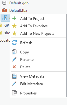

I still can't see the option to share as a web tool. From the ribbon I can share as a geoprocessing package, but it looks like it still doesn't recognize that there's a server available to share to, even though it's in the same project folder and is set to admin, since that's another requirement.

I think the difference between our screen shots is I'm connected to an ArcGIS Enterprise portal with a federated server and you are using a standalone server.  My suspicion is the workflow you're using clearly won't work rather you'll need to create a service definition file for a geoprocessing service to your server.  This workflow is listed here and here.
