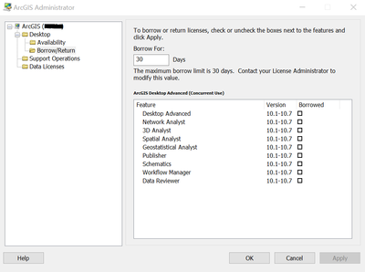

Not sure if this applies to ArcGIS Pro but when I was an ArcMap user I could open ArcGIS Administrator and "Borrow" licenses for up to 30 days.

It's true that ArcGIS Pro can borrow a license on a laptop (to go to a conference), and it does so for 30 days. During that time the same named user cannot use ArcGIS Pro on their workstation.  And while this is a suitable workaround for the situation at hand, the documentation does say that Portal users can check out licenses remotely and, for us, that is not working.  I posted here in an attempt to figure out why.  What I can do is log a ticket with Esri and post the answer here afterwards.
